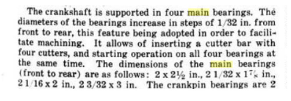

My apologies for not clarifying the above. The '57 and earlier stovebolts have eccentrically shaped main bores which require the use of shims to size the bearing clearance. As above, it's possible to remove the shims, nip the caps and bore the bearing bores round to use '58-'62 bearings.PackardV8 wrote:Many stovebolt owners ask to have them line bored all to the same diameter as the later 6-cyls and used those bearings.

Basically, yes. It's actually simpler than that. The shims can be eliminated. the shims were .004", with the .004 shims in there, it should be round and on-size. If you want to removed the shims probably won't need to cut the caps at all, jsut bore it.
But due to people messing with them sometimes it's a real puzzle, if they have been repaired by farmer brown, who, having already pulled all the shims decides to file the caps to tighten it up, unevenly, at an angle, and then he ruins one and grabs one from another block..... Also the lockwashers destroy the surface of the caps with repeated loosening and tightening.
There are more than two kinds of bearings, but the modern book only lists two. I have some catalogs from the 70's that show the other variants, I believe the thrust width is different. WW2 era engines were made in several plants geared up for the war effort, and they apparently used slightly different bearings and sizes all at the same time.

i assume they did it for the same reason they do with cam bearings bores. Why did chevy do it? I'd guess it would be a way to speed up production with whatever method they were using to bore the main housings, but I'm not sure, I don't know how they did it. Before my time. But It may have been something more like a giant reamer rather than line boring with single point tools. ...
This thread popped up in the forum; search engines are better now and the problems that the 240Z experienced with early production straight six engines inspired me to search again: viewtopic.php?f=15&t=49273&p=835091#p835091
The key is to use "stepped" main bearings or shaft as a search parameter rather than staggered.
https://books.google.com/books?id=iP4iA ... ll&f=false
So modok is correct.
