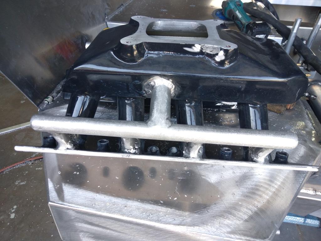

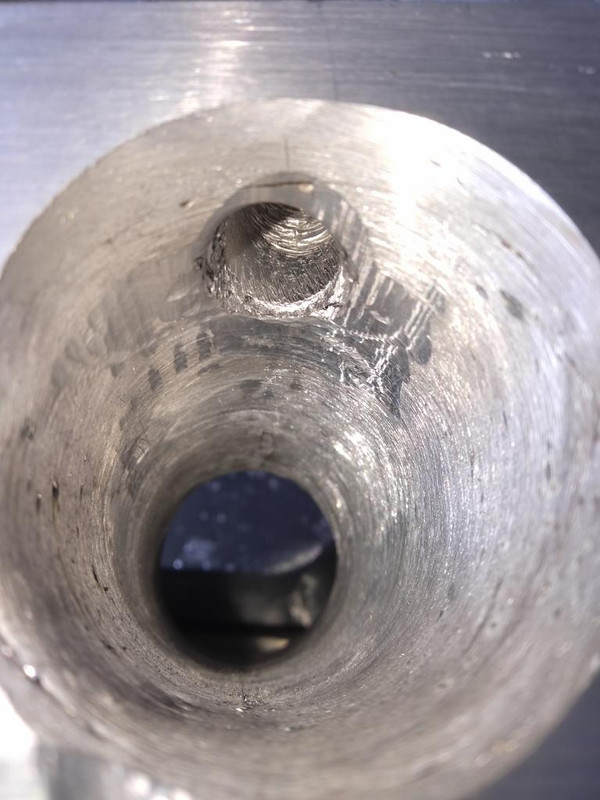

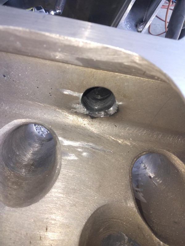

So I've started some modds on my intake I wanted to try, I've done similar before by linking the ports together but wasn't linked back to the plenum, it did seem to improve idle and drivability.
Would this help with max CFM available to the port, would it also draw easier at idle from the small port and help balance the feed to the runners ?
Blowing air down it it feeds the front and rear mostly which is probably what is needed with the design of the intake.
It's not pretty but I can work on that when it finished. Cheers

I'm also looking at those runners (also with zero experience) thinking they could do with more radius. Is it possible to put a plate over the whole floor to build it up to get more material to make a better radius? It would immediately cost you in plenum volume though.
I take it you want to keep the carby style look too it all though? If you weren't and could have port injection you could easily go to side mounted throttles and have a lot more vertical room available (for said plenum volume)

BTW I have no idea what you are trying to do by cross connecting the runners. I think it would kill the pressure wave/signal you are trying to make with the longer runners.

Some points re dual plenum cross rams and connecting passages:
- David Vizard told me that he and Terry Walters spent a week trying to tune up a BBC with an Edelbrock XC96 cross ram (dual plenum) and that when they gave up and switched to a single carb single plane, gained 100 HP.
- I have one I'll be trying on my 495" BBC. The previous owner had fitted it with mechanical injection and added a 1" diameter balance pipe, the latter presumably for good reason.
- Since I loved the factory cross ram I used on the SBC in my '70-1/2 Camaro and it had a single plenum, I'm in the process of fabbing a 3" square connecting passage for the XC96 and plan to tune with the passage open, then see what happens when I block it off.
- I was looking at a magnesium Barton Hemi cross ram (single plenum) the other day and noticed that it has three connector passages of ~ 2"² area each cast in but sealed off at the ends, presumably to allow selective opening for experimentation.
- I assume the Barton worked pretty well, as the aluminum Hemi underneath it had "1125 HP" inscribed on the rocker covers.
