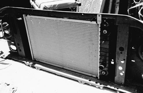

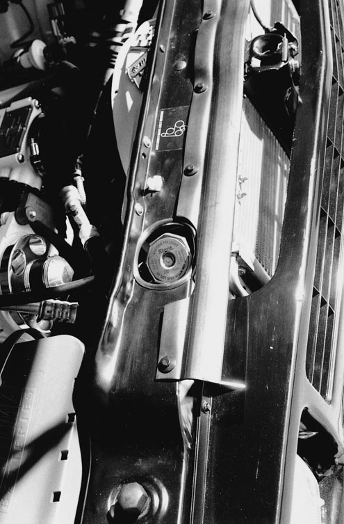

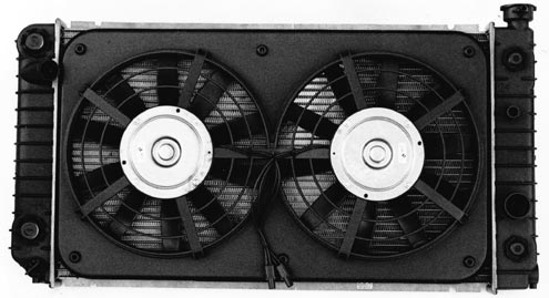

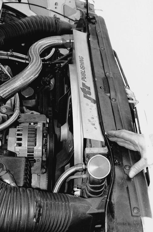

You can keep it cool whether you run a 350 or a 400 and there will be room for a fan, econo racer. Here are 2 possibilities ('85 - '89 Corvette heavy duty radiator and the heavy duty radiator for the 4.3 litre V-6 S-10 trucks)......
http://www.superchevy.com/how-to/46298- ... gine-swap/
"The good news is that a stock, high-efficiency Corvette radiator can be bolted in with little modification. JTR has tested four different aftermarket custom-built radiators, with moderate success, but found that the ’85-’89 Corvette HD radiator is the best at cooling a V-8 S-truck.
This aluminum radiator features plastic side tanks and is quite similar to the stock radiator used in all ’87 and newer S-trucks, which is why it fits and cools so well. It’s very light, weighing about 10 pounds, and its high-efficiency aluminum core cools extremely well, even in an A/C-equipped truck.
The Corvette radiator is also very thin, offering a ½ inch more clearance between the fan and radiator when compared to a typical 2-inch-thick brass radiator most custom shops would build for this type of swap. A ½ inch may not sound like much, but JTR claims it makes a huge difference in cooling effectiveness because the engine-driven fan can have more pitch, which increases airflow through the radiator. The ½-inch gain in clearance requires some hammering on the radiator core support so that the side tanks sit far enough forward (see photos). The Corvette radiator is also equipped with an automatic transmission oil cooler, which helps because there is very little room to install an auxiliary cooler in front of the radiator. JTR recommends using either an 18-inch-diameter aftermarket flex fan or, after modifying the core support further (see photos), running a factory clutch fan to cut down on highway fan noise."
"Mounting the Corvette radiator in the standard location requires some hammering around the filler neck but is otherwise easy to install using stock rubber insulator pads from an ’87-’93 S-truck and fabricated mounting brackets (PN 12338053) available from Stealth Conversions. More info on radiator mounting is in the JTR swap manual."
"The Corvette radiator can be mounted even further forward by cutting out the top layer of the radiator core support’s lower double-wall mount. The ’87-’93 S-truck rubber isolators can be used with the Stealth Conversions brackets to secure the radiator in the “forward” position. When mounted this way, there is an additional 1-1/2 inches of clearance between the water pump and radiator, allowing use of an engine-driven clutch fan. Auxiliary electric cooling fans are usually not required when running this combination."
"When mounted in the “forward’ position, the radiator’s fill cap will be covered by the core support. An access hole must be cut in the core support for the fill cap, or an aftermarket fill cap and tee fitting (Moroso PN 63730) can be spliced into the upper radiator hose."
"Cooling can be one of the toughest parts of the V-8 swap. This is another possible cooling combination using a HD 4.3L V-6 S-truck radiator—which is wider than the Corvette radiator recommended—mounted with a Flex-a-lite dual electric fan model 210. The fans are thin enough to install between the radiator and long water pump when the engine is set back 1 inch (this is covered in the JTR manual)."
