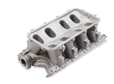

Yes... Price Motorsport Engineering. He told me he had a version of the 427 Tunnel Wedge intake for the 351W on prints but has not as yet brought it to casting. That would be an interesting intake on my setup.
I have looked at the new Holley Hi Ram intake and have seen dyno test on engines like mine but for the cost of all involved and changes needed
to the hood...it is tall... decided to keep what I have when looking at the power gain and torque loss where I spend most time.
