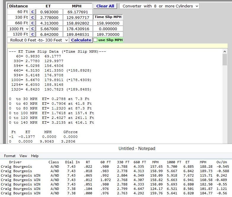

Craig-Bourgeois-2019-Comp-WIN-Gatornationals
working on new version ETA Simulation = ET Time Slip back into HP and TQ Curve
Rough-draft so far ...pretty decent correlation

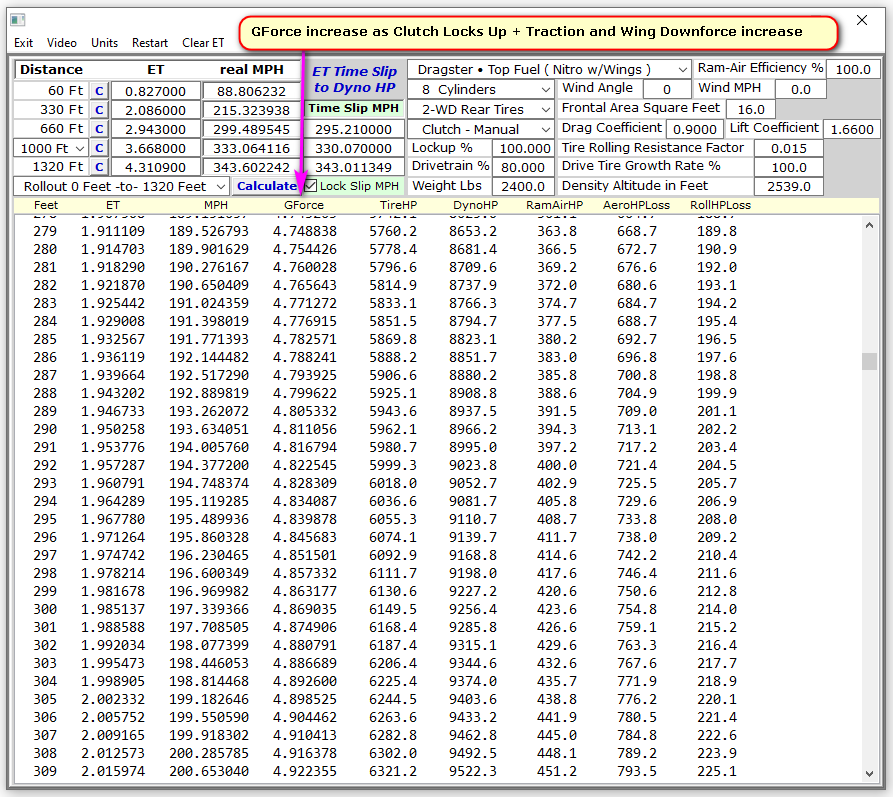

Post by maxracesoftware » Thu Dec 05, 2019 2:33 pm
first prototype ScreenShots of ET_Analyst Pro 2019-2020 ( ET Slip Data back into Dyno HP )
1st basic "bare-bones" highly accurate working version .... can Model these parameters :
[1]= 1 Wheel Drive ( MotorCycles ) + 2 Wheel Drives + 4 Wheel Drives or All Wheel Drives
[2]= Torque Converter/Automatic Trans and Clutch/Manual Transmissions, as well as , Converter/Clutch Slip or Lockup % percents
[3]= Total Drivetrain Efficiencies
[4]= Ram-Air Hood Scoop HP effects
[5]= Wind MPH and Wind Angle effects
[6]= Aerodynamic effects , such as , Drag and Lift Coefficients , Downforces
[7]= Tire Growth Rates + Tire Rolling resistance Factor
You enter your ET Slip's Time Data ( and you can optionally enter your ET Slip 660, or 1000, or 1320 MPH's if you like to ? )
or just go with what MPH's the Program predicts

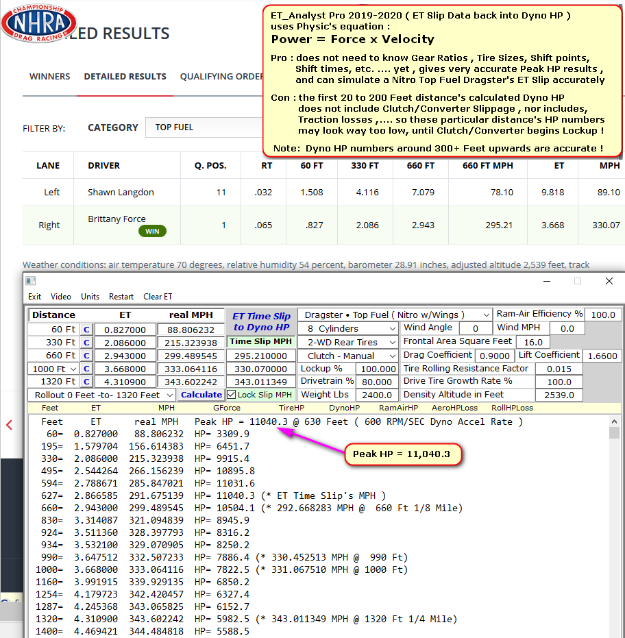

Post by maxracesoftware » Thu Dec 05, 2019 2:36 pm
Nitro Top Fuel Dragster ( Simulation examples )

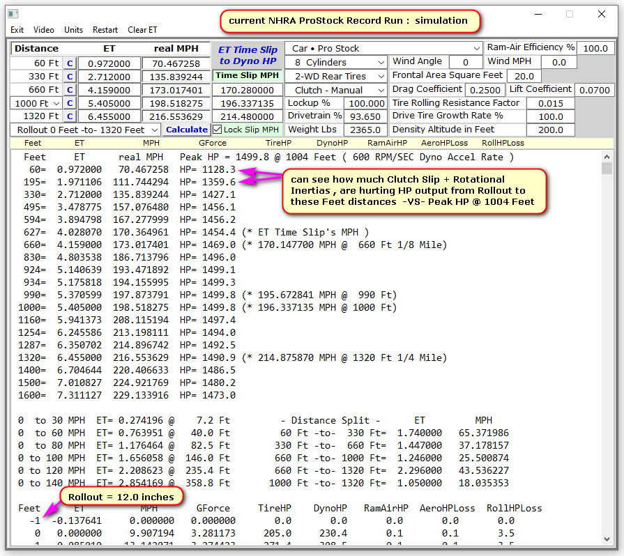

NHRA Pro Stock Record Run simulation :

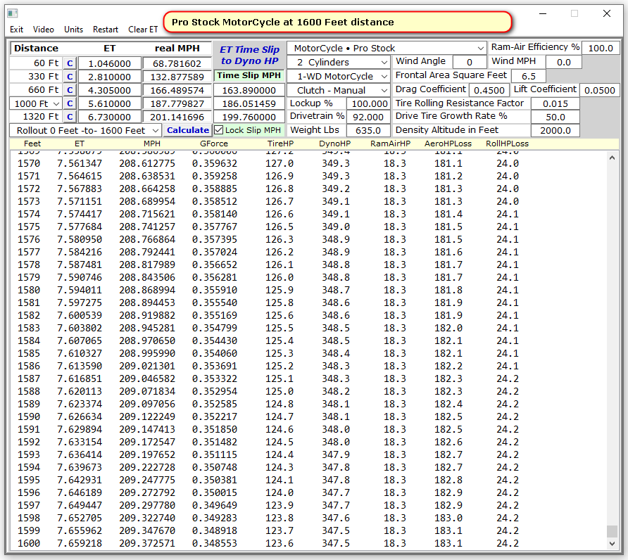

NHRA Pro Stock MotorCycle Simulation Run example :

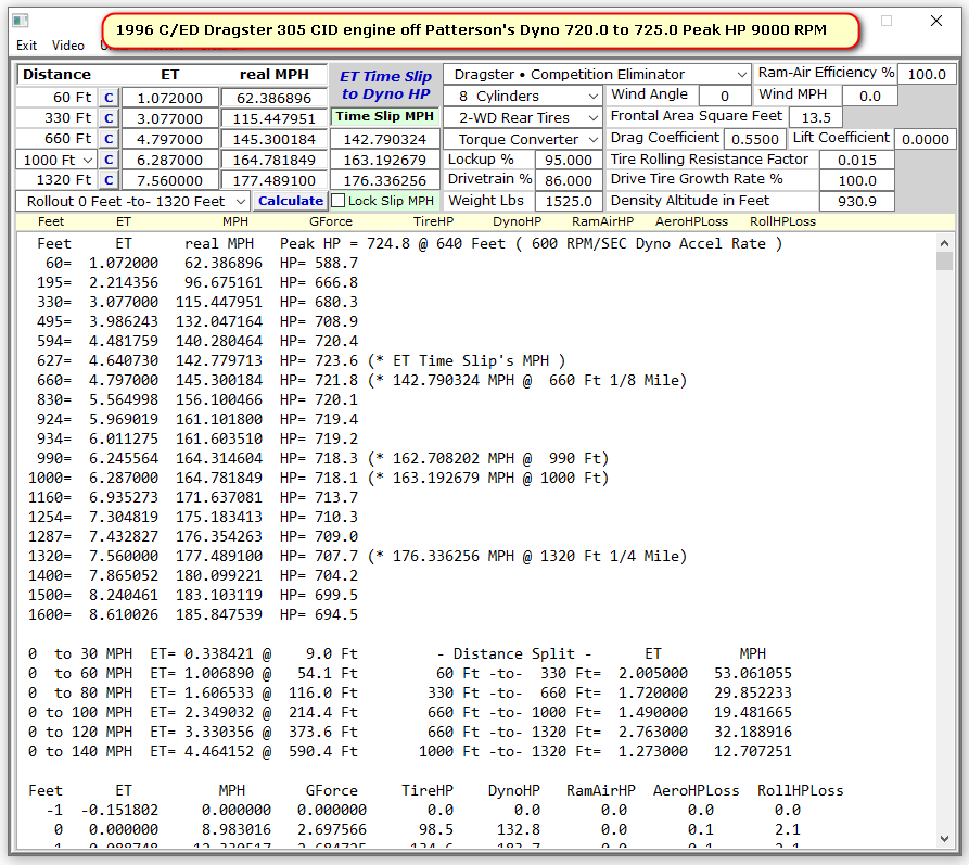

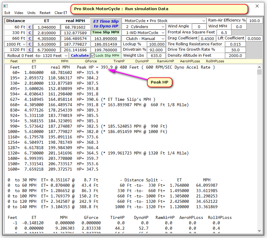

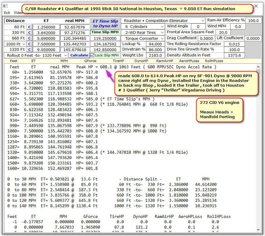

Re: 1320 Feet MPH Comparisons between V8, V6, S6, 4 Cylinders
Post by maxracesoftware » Thu Dec 05, 2019 2:40 pm

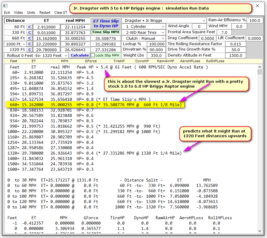

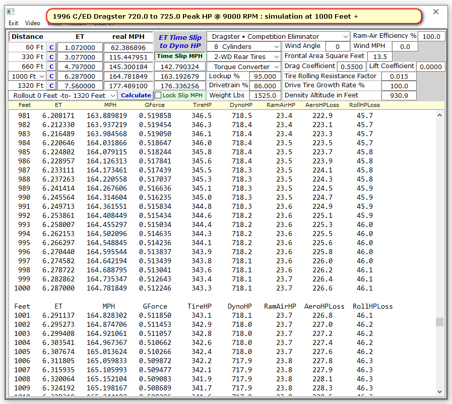

NHRA Competition Eliminator year 1996 C/ED Dragster Simulation Run example :
NHRA Competition Eliminator year 1995 C/SR Roadster Simulation Run example :
NHRA Jr. Dragster Simulation Run example :
Post by John Wallace » Thu Dec 05, 2019 8:25 pm
Nice!
Is the C/ED dragster a rear engine dragster?
John Wallace
Pontiac Power RULES !
www.wallaceracing.com

Post by maxracesoftware » Thu Dec 05, 2019 11:04 pm
Nice!
Yes, it was a Rear-engine Dragster
i guess i need to make more destinctions in the drop-down choices
there is already a Nostalgia Dragster choice , which is a Front-engine Dragster
