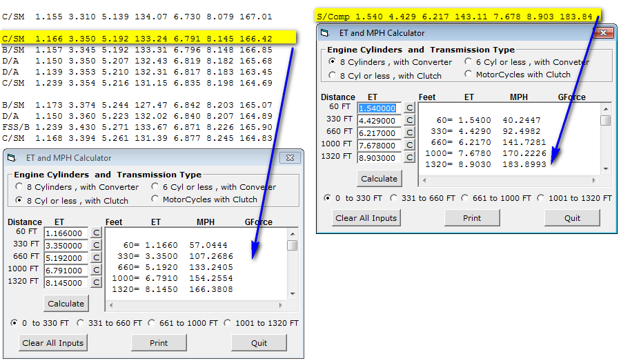

below is a Screenshot of 1992 version ETA_Calc ,
which is a little ET/MPH Calculator that will generate ET/MPH/GForce Data every 1 Feet of Distance
it does a pretty good job even on a very fast MPH Super Comp 8.90 ET/MPH with a Throttle Stop

For anyone reading this Thread in future...
in the Picture above :
those various C/SM, B/SM, D/A , ET/MPH incrementals
are real Dragstrip Run Data ... just a Log of good NHRA Event Qualifying Run Data
and the "ET and MPH Calculator" is just simulated Run data of the real incrementals
to see if there are any acceleration problems,
or to see how good the correlation is ,
or to even use the "ET and MPH Calculator" as a sort of "Lie Detector"
to catch anyone Posting "Bogus Dragstrip Run Data"
i don't have actual Engine Dyno TQ and HP Data
for those various Class Cars above ,
to make a comparison of the ratio of CDA to HP of each vehicle or HP/CDA
the simple "ET and MPH Calculator" can calculate the exact HP at the Tire Contact Patch
each Foot of Distance , but to reverse engineer ET Slip back into an Engine Dyno TQ and HP Data/Curve ,
would need a bunch more inputs like this "minimum inputs" in this next Pic below :

1000 Ft= 6.603 <<---- Look at this 6.603 @ 1000 Ft ... it matches the 2nd fastest V8 Car out of the Group below
1320 Ft= 7.996 - 160.79<<--- now the 4 Cyl 's MPH is rapidly changing -VS- the V8 Car Group ... basically same effect a ProBike -vs- ProStock Car
136.18 MPH - 135.14 MPH = -1.04 MPH Loss @ 660 FT
169.34 MPH - 160.79 MPH = -8.55 MPH Loss @ 1320 FT
Code: Select all
Class_60FT_330FT_660FT_MPH_1000FT_1320FT_MPH
C/A 1.113 3.249 5.052 137.48 6.603 7.911 171.69
C/A 1.116 3.255 5.053 137.71 6.601 7.911 171.26
C/A 1.133 3.264 5.057 137.00 6.610 7.919 172.08
A/SM 1.112 3.259 5.054 136.18 6.614 7.934 169.34
C/A 1.125 3.275 5.095 135.54 6.660 7.980 170.97
C/A 1.131 3.288 5.100 135.91 6.665 7.987 170.00
C/A 1.176 3.283 5.101 135.31 6.669 7.993 169.74
or Vice/Versa --> give the ProStock Car the same low CDA of a ProBike ... again the 1320 Ft MPH would be a giant difference !
However ... 60ft, 330Ft,660FT , and sometimes 1000 FT .. not much differences ... its really starts showing up around 1100 ft to 1320 ft
if you look closely at my old 1992 ET/MPH Calculator ... thats the reason i had to split up the Number of Cylinders into those Catagories
same thing with Transmission Types / Combinations .... to account for or to predict the 1320 Ft MPH correctly !
- John Wallace

Maybe find some 1/8th mile racers ET slips?
(who race only 1/8th mile)
Wonder if it might be because most 1/4 mile race vehicle are geared for 1/4 mile.
Maybe the engine is 'topping out' and not pulling as hard after a set point.
But I guess this still doesn't explain the 4/6/8 cylinders MPH difference probably.
Still would be interesting to see if geared for 1/8th if the incremental would still favor 8 cylinder engine.
John Wallace
Pontiac Power RULES !
www.wallaceracing.com
Re: 1320 Feet MPH Comparisons between V8, V6, S6, 4 Cylinders
This! At the top end, the drag force per HP has a rapidly growing effect.John Wallace wrote: ↑Sat Apr 14, 2018 8:21 am Would you have a comparison of the ratio of CDA to HP of each vehicle?
(or maybe HP/CDA)
Interesting thread.
What would the numbers look like if you doubled the HP and the weight of a vehicle but left all other parameters unchanged? Could also look at predicted top speed over a many mile course for a more dramatic illustration of the effect.
PS: I don't know of anything in physics that supports the theory of impulse frequency affecting performance.(apart from the extremities of being shot from a cannon vs. a constant thrust rocket )
