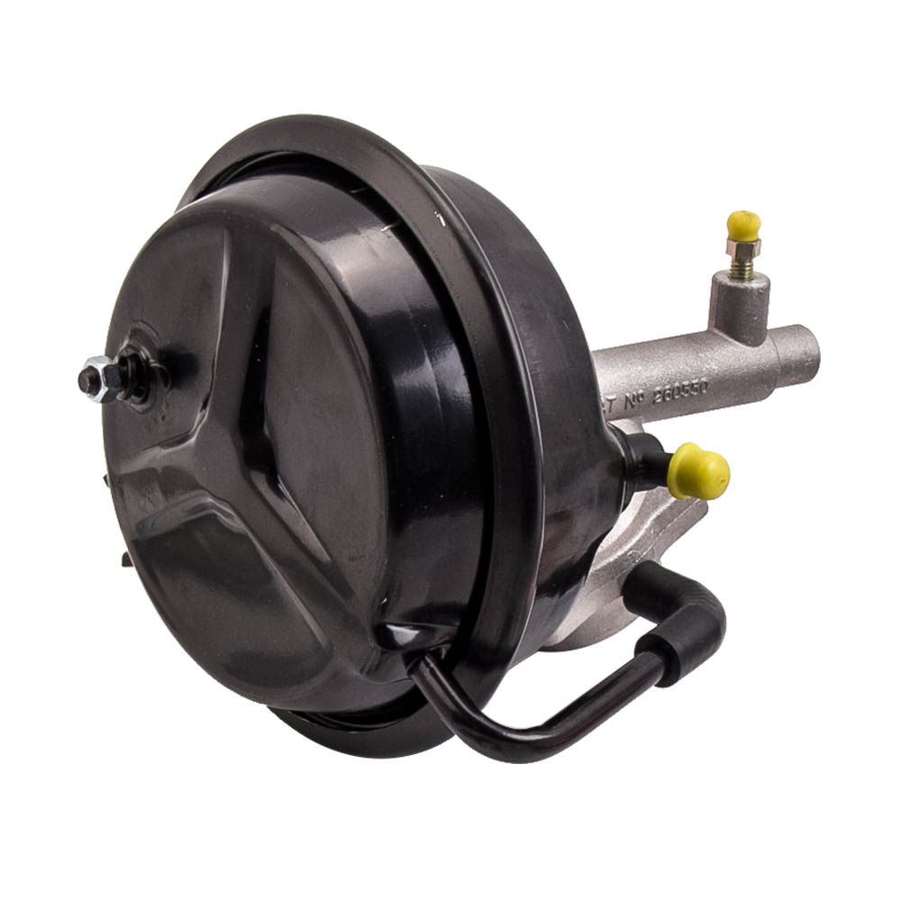

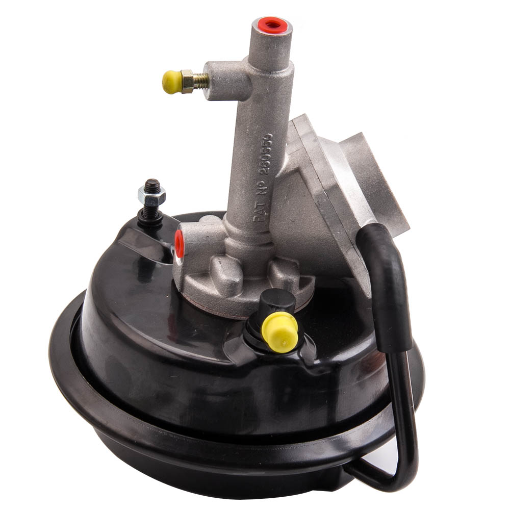

Thanks, chevyfreak! I will check out those pedal options. Appreciate the idea. Might be able to fit pedals and master cylinders under dash and place remote reservoirs on firewall or even inner fender panel to get the clearance I need.
I have found some remote servo assist (power booster) units listed on Aussie e-bay. Bought one to add between hydraulic clutch master and slave cylinder to help these worn out knees and retain a manual transmission.
I am wondering if such a remote servo might work with my relocated brake master cylinder as well. Only rub other than price seems to be that these remote boosters have only a choice of 5/8" or 3/4" slave piston diameter whilst my brake master cylinder has a 1-1/8" piston. So I am wondering how that would work out?
This is a VH44 remote mount servo. Plumbs into hydraulic system anywhere it can be fitted. Uses vacuum for boost......

Re: Relocating brake master cylinder off firewall
Well, this is turning out to be an interesting project.
Appreciate the suggestions for hydro-boost. If the hydro-boost unit can be clocked so as to rotate the piston from 10:00 to 2:00 o'clock position so it is on outboard side of engine bay (to solve clearance issue with long runner intake I built), I might be able to do that. However, have elected to go with a remote mount hydro-vac unit instead.
Here is where I am at present......
Will use the Aussie sourced PBR VH44 remote mount vacuum booster where retro-fitting Jeep clutch master cyl. and external slave cyl. to my '57 Chevy.
Can match VH44 with slave cyl. size of 3/4" to Jeep clutch master cylinder......
However, the VH44 unit is not made with piston size large enough to match my brake master cylinder, so managed to find a rebuilt remote mount hydro-vac unit for 1963 and 1964 Chevy C50 dump truck. This operates on the same principle as the VH44 unit, only its larger......
Next problem will be where to mount the 2 hydro-vac units. May need to move one or both of them to the trunk. The shelf above the rear axle would be a good place, but I usually mount a modified '62 - '64 Chevy gas tank there as an auxiliary tank when building a '55 - '57 Chevy. That gives a cruising range of 650 miles at highway speeds if both tanks are filled.
Engine is cammed for low to mid-range power and should have good manifold vacuum, but it would probably be a good idea to add a vacuum canister. Also...... I have a new early 1990s Cadillac electric vacuum pump around here somewhere. These used to be popular with circle track guys some years back. May as well use it. Will also look into pressure sensors to cut vacuum pump off and on as needed. Anyone have a source for these?
The saga continues. Should have titled this thread, 'As The Hydro-Vac Turns' or some such thing.
For the hydraulic clutch, will not be using the Aussie sourced VH44 unit after all. Scored a NOS Bendix remote power booster for '55 - '59 Chevy 2 ton truck still new in its original box last night. These Bendix power boosters are 7" diameter as well but longer than the VH44.......
And more compact than the Delco Moraine '63 C50 dump truck hydro-vac I will be using for the brakes. That one will have to go in the trunk for sure. Its huge......
