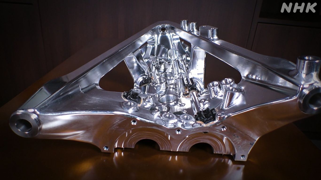

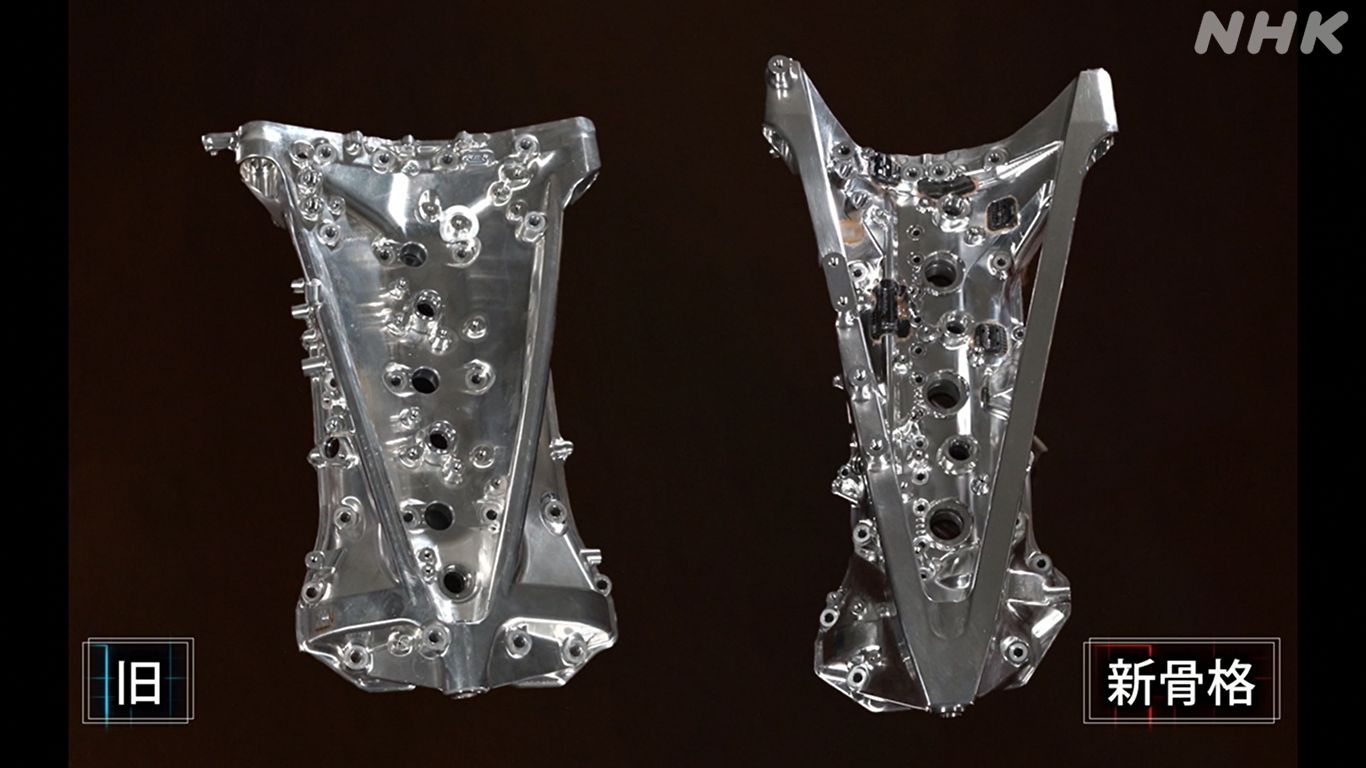

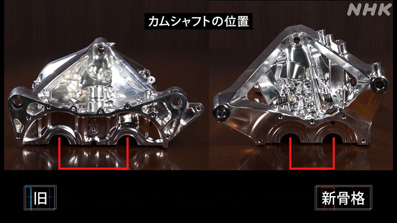

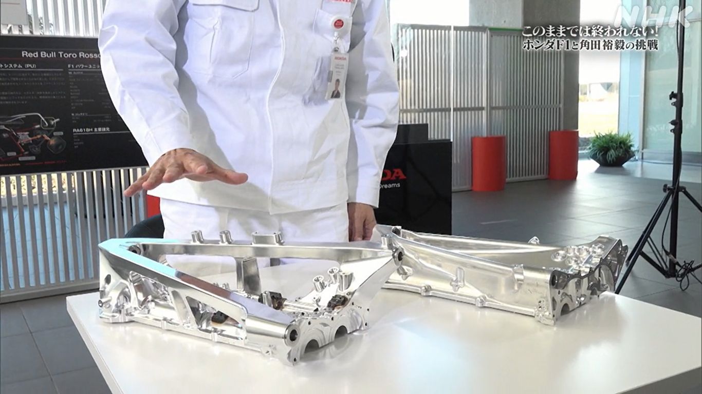

Re: I Still Like Pushrods, They're Still Viable
The way to go is with even flatter chambers than that.
Here is the new Honda CBR1000rr-r valve angle:
they stood up the valves on their current F1 engine as well.
Two things, when you get around the fact you don't need pushrods passing through the head, it opens up options for port alignment. The second is when you get past a carburetor, you can do just about whatever you want with the intake port geometry... it doesn't have to pop out under a venturi like a 4bbl needs.
-Bob
